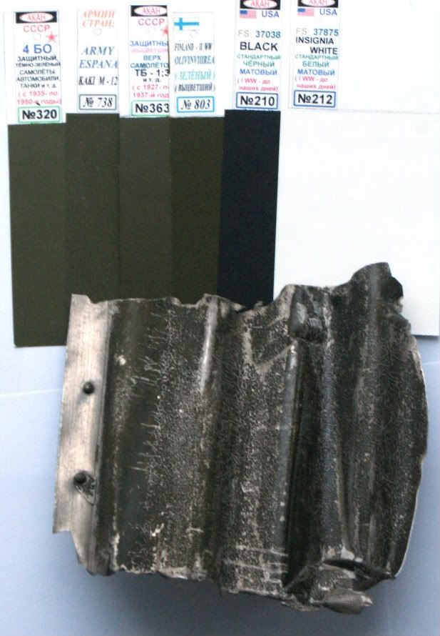

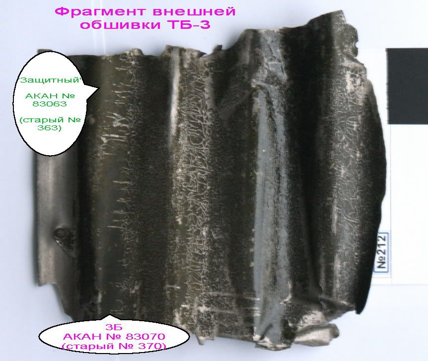

Akan kindly posted following photos of the original TB-3 fragment painted with mid-1930-ies “Zashtitniy” and 3B paints:
Just as an idea how TB-3 looked:

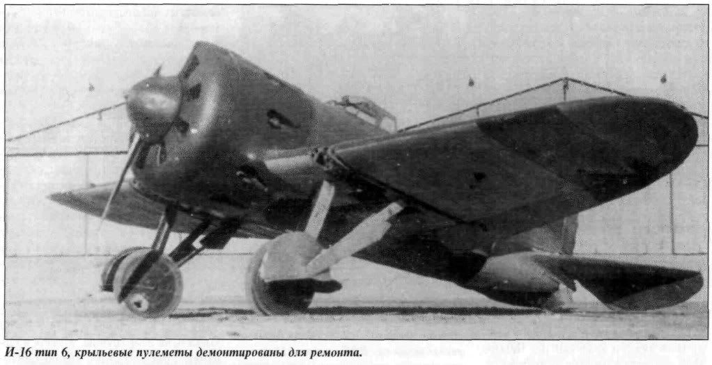

Series I-16s made in 1936 had black engine cowlings and black “stoiki shasi”
HTH, Smile
KL

About TB-3 colours:
http://www.retrospicere.narod.ru/library-books/book_998_2.htm
Бомбардировщик сверху красился в «защитный» (зеленый с желтоватым оттенком) цвет. Состав был таким: 42% крона, 27,3% олифы, 25,5% умбры и 1% сажи. Снизу самолет был светло-серым: 34,84% литопона (смеси солей цинка и бария), 34% свинцовых белил и 31% олифы. Внутри машина красилась в серый цвет: 31,6% литопона, 31,6% свинцовых белил, 2,2% крона и 33,8% олифы.
Only oil paints were used to paint metal planes. You are safe if you say “Protective (green)” oil paint for upper surfaces and “Light Gray” oil paint for undersides.
I would be cautious with AE oil enamels; we know more about AE-9 and AE-8 because they were used on SB and DB-3 bombers.
AE-7 and AE-14 are mystery - when introduced, on what planes used, what colours???
