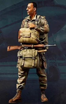

p.s А парашютисты, которых стоит собирать, это вот например:
https://www.scalemates.com/products/img/2/7/3/1048273-14702-65-pristine.jpg
https://www.scalemates.com/products/img/0/6/1/953061-13441-57-pristine.jpg
https://www.scalemates.com/products/img/0/5/9/953059-13441-69-pristine.jpg
http://www.bestsoldiershop.com/cart/fbf7_kc0_p0459_00.jpg
https://ae01.alicdn.com/kf/HTB1ov.fJFXXXXaMaXXXq6xXFXXX9/1-35-WW2-US-101st-Airborne-D ivision-9-soldier-Resin-Model-Kit-figure-Free-Shipping.jpg
https://ae01.alicdn.com/kf/HTB1k.zZOVXXXXcWXXXXq6xXFXXXo/Free-Shipping-1-35-Scale-Unp ainted-font-b-Resin-b-font-Figure-US-font-b-paratrooper.jpg
